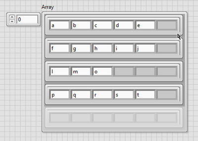

The best way to do this is with an array of clusters of 1-D arrays.  See a similar question I posted last year for more details:  http://forums.ni.com/t5/LabVIEW/Uneven-2-D-Array/td-p/2497412
To summarize:
Only real solution is an array of clusters each containing another array.
