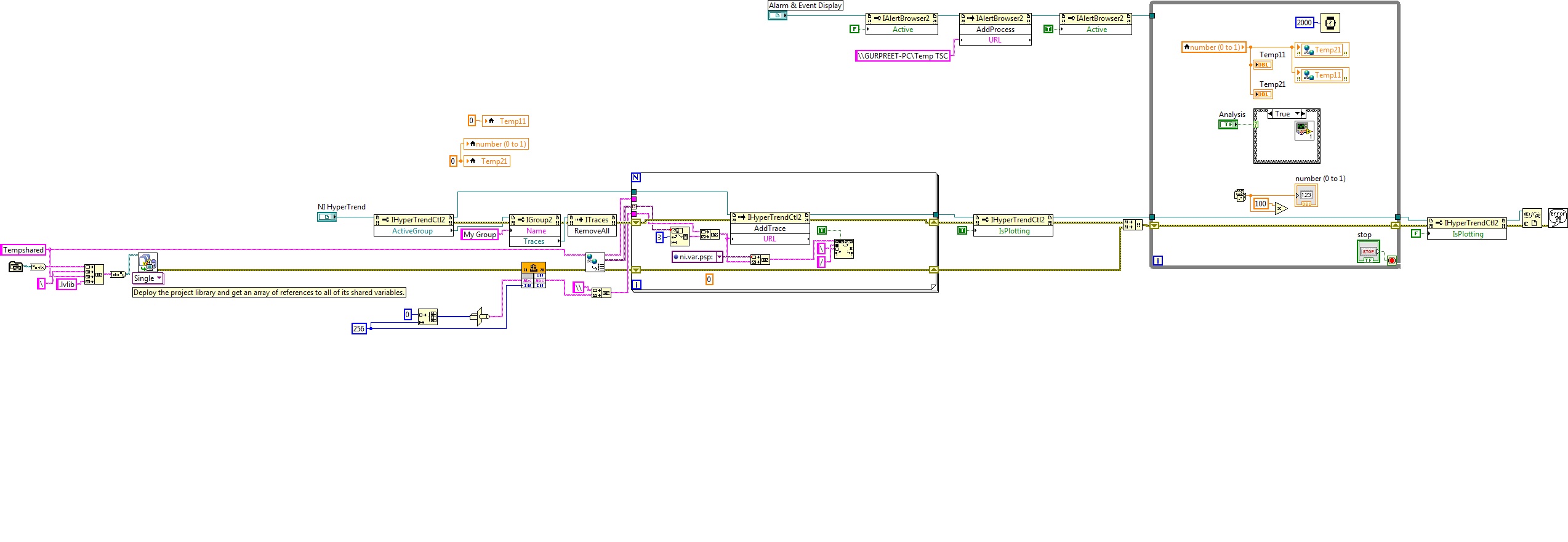

Hi preet_singh,
You don't have to create new posts for every explainations. I'm not really sure why you do really need to use ni psp. Unless the main VI is running at the different computer than subVI.
First, what you really want these 2 VI's to do? Are they going to be running on the same computer?
Let's say, both of these VIs are running in the same computer. Can you remove the functions like Get Shared Variable Lists.vi, Open Variable Connection.vi, Write Variable.vi and etc. Remove the indcator's data binding (make it unbound).
It should be something like below:
May I ask why you need to use For loops? If you have no use of them, you can just remove it.
