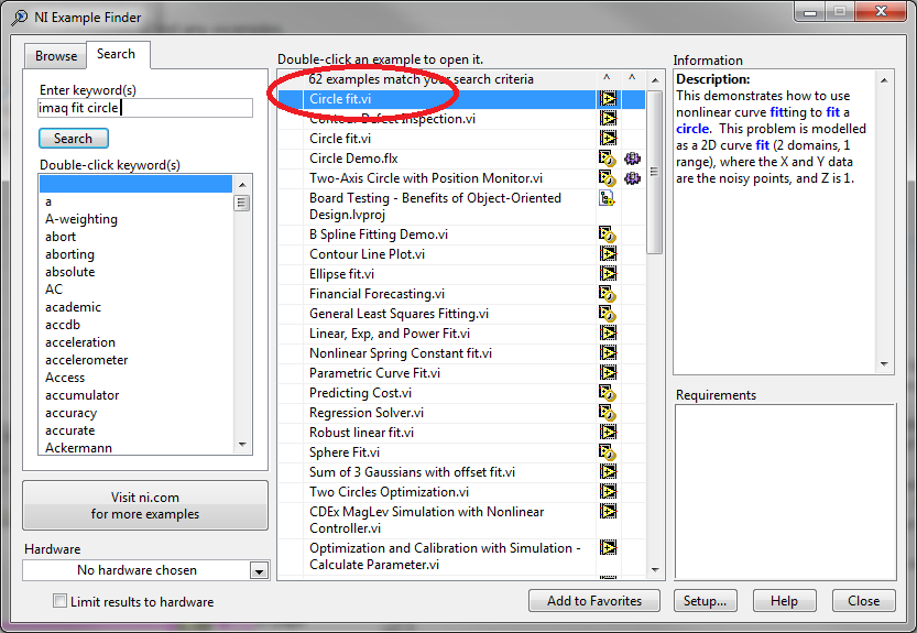

Use NI Example Finder.  You should be able to find examples on your computer if you installed IMAQ.

I looked, not sure I found anything immediately suitable for solving the Original Poster's question.  The Examples are also not that easy to find -- look under Toolkits and Modules, where you'll find the Vision folder.

Thank you for advice.
I searched the example library, but I could not find any examples.

You didn't found this example?
