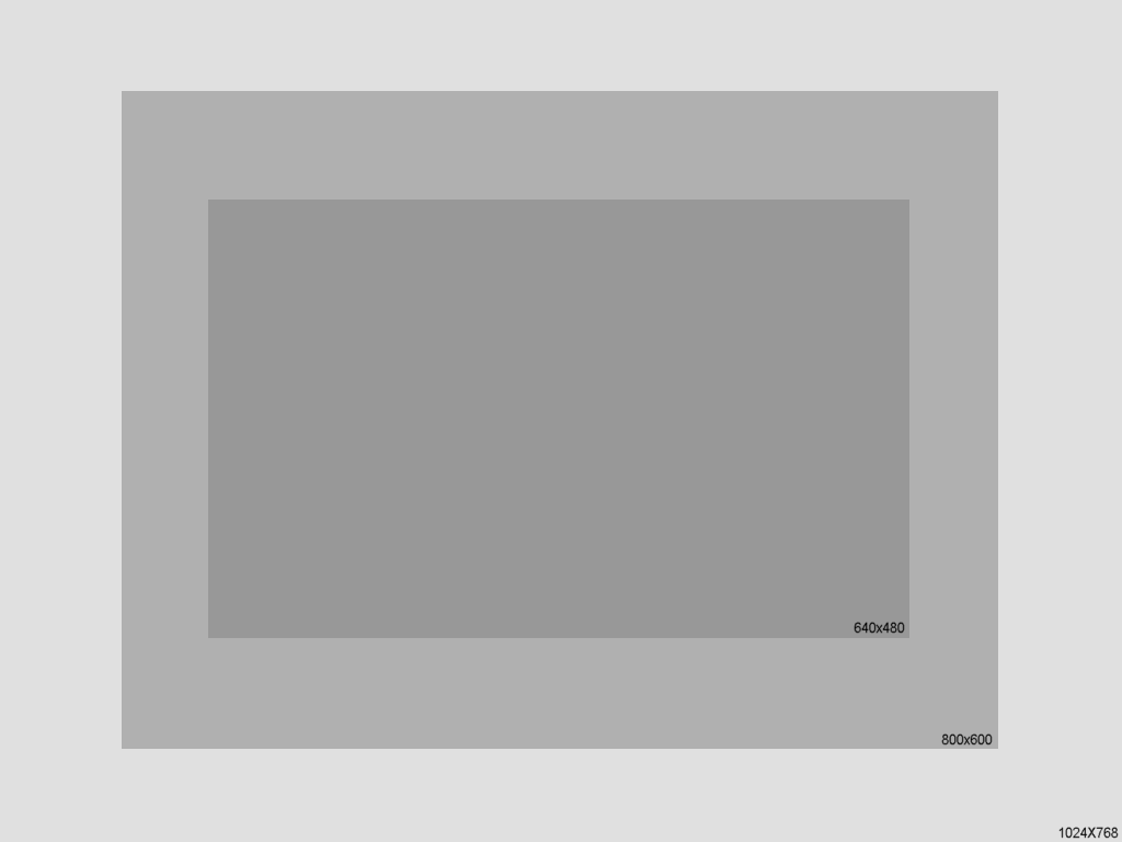

I'd recommend keeping a desktop picture like this handy for testing what your VIs look like at different screen resolutions:
Might need to use a photo editor and draw your own.  I have one that scales from the top-left, so I can just drag the window resizer to the different rectangles and see what's visible and what isn't.

Like SnowMule, I like to have a handy reminder of the screen sizes.  One technique I sometimes use is a blank VI with rectangular box decorations set to the screen size(s).  This can also be used on blaock diagrams if development is done on multiple computers.

thanks fot the tip but I am looking for an answer/recommendation to my question about the vi server approach.
