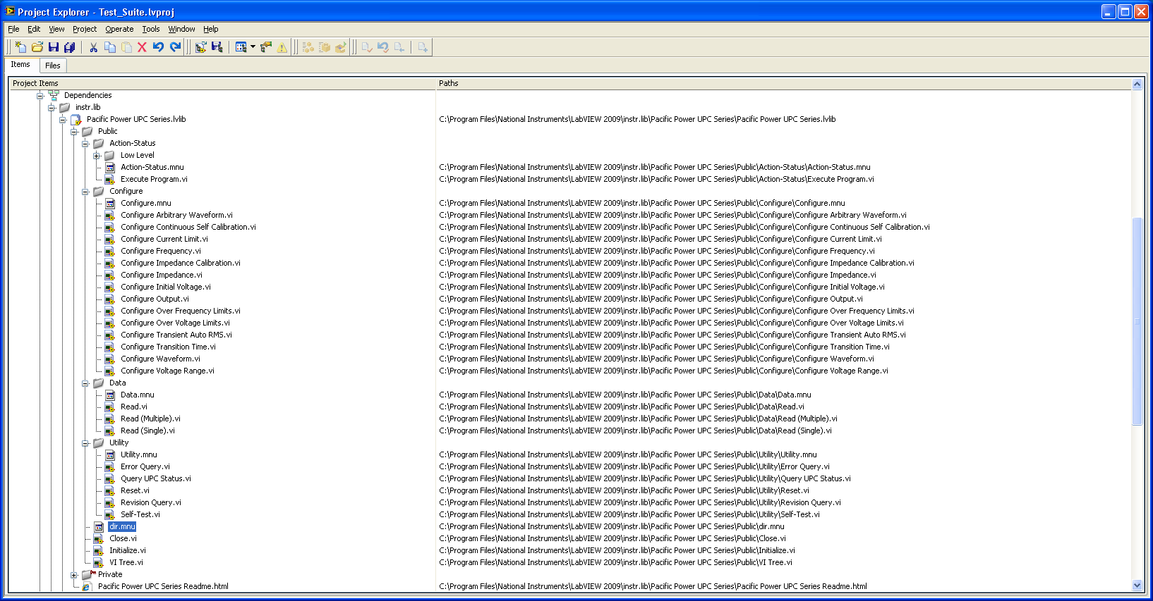

   I have a conflict in my LabVIEW project which I can't resolve. When I open a vi in my project I get a "Project Dependency Conflicts Detected" dialog:
22631iB47C05C4127126BE
   When I close this window the dependency section of the project manager opens:
22633iAE4E1435D22694E9
but the items aren't highlighted with the usual conflict icon and the "reolve conflicts" menu item is greyed out. I previously had an older version of the Pacific power library installed, but I've removed that from my instr.lib folder. Does anyone have any idea how to resolve this?

Dear Tim
The reason this is occuring is the instrument driver you uninstalled; Pacific Power UPC Series, was previously located where all instrument drivers reside; in the instr.lib folder. Having deleting/removing this, VIs in your project still require these dependencies which no longer exist.
Have you tried reinstalling the driver? If this fails, I suggest mass compiling the project. Please see steps below:
1. From the project, open the VI or VIs that call the instrument driver. LabVIEW will look for the driver VIs in instr.lib, which no longer exists.
2. Choose "Browse" and navigate to your driver library on the shared drive. This added my driver library as a dependency to the project.
3. Save and close the VI.
4. From the project, go to Tools >> Advanced >> Mass Compile...
5. Navigate to the folder containing your .lvlib file and select "Current Folder."
6. Mass Compile.
7. Save the project and close it.
Many thanks for using the NI forums and I look forward to your reply.

Hello David,
   Thanks a lot for your response. I haven't re-installed the old driver, as I'd like to continue using the updated one. I've tried the mass compile option that you suggested, but I missed out the first three steps as there are no VIs which call the .mnu items. I'm afraid the mass compile hasn't solved the issue. I can send the log to you if you would like, is there anything else you can suggest that I try?
   Cheers,
    Tim
