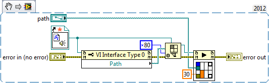

See if that's about what you're after. 😉
/Y
Qestit Systems
Certified-LabVIEW-Developer
