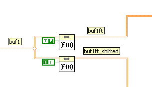

I just finished porting some code from Matlab to Labview.  There are a couple of 2D FFT's in the code... the matlab version computes the 0,0-centered FFT, then uses fftshift() to obtain the middle-centered FFT.  It then makes use of BOTH versions (does its own calculations with one, interfaces to some other code with the other).
Right now, I'm replicating this in Labview by doing 2 FFT's for every 1 in Matlab, one with "shift?" true and one with "shift?" false.  Obviously it is quite a bit slower!
I thought I'd ask here if anyone has replicated the shift code before I tried it myself? It will greatly speed up my program... and that's the whole reason I took on this little code-porting project in the first place!  Help would be greatly appreciated.

I agree completely, Mello.  I actually don't have Matlab available (although I've used it extensively before), so that's why I'm porting the code.  I don't think I explained my problem well enough.
In the Matlab Code:
buf1ft = fft2(buf1); % takes the 2-D FFT, DC at (1,1)
buf1ft_shifted = fftshift(buf1ft); % Puts DC in center of array
Note that fftshift() doesn't actually do a transform, it just rearranges the data so that DC is in the middle.
buf1ft and buf1ft_shifted are used in separate places in the code later on.
In labview, I've had to replicate this by doing 2 separate FFT's because there's no fftshift VI (to the best of my knowledge), although it's an option on the FFT VI:
Performing the second FFT with shift=true is a lot slower than copying and moving around the data from the first FFT so that DC is centered.
I was just hoping someone has been here, done this before.  Writing the labview code to shift around the data isn't impossible, it's just a pain because I don't know what it does when the sizes are even/odd, etc. and I would like to save myself some time.

It looks like the example that ships with LabVIEW "2D FFT of a Pulse.vi" does the shifted and non-shifted the exact way that you are, with two FFT nodes. So, I am not sure there is a faster solution.
Does your install of LabVIEW have the MathScript node (under structures in your function pallette)? I tested your matlab code above and it executed just fine. The mathscript node itself is not very fast, so you'll have to do a compare and contrast with your code to see if it is worth it.

Thanks for investigating, Mello... too bad.  I'll probably just write a C routine that juggles around the 4 quadrants of the FFT (since it appears that's all fftshift does) and compile it into a dll.
