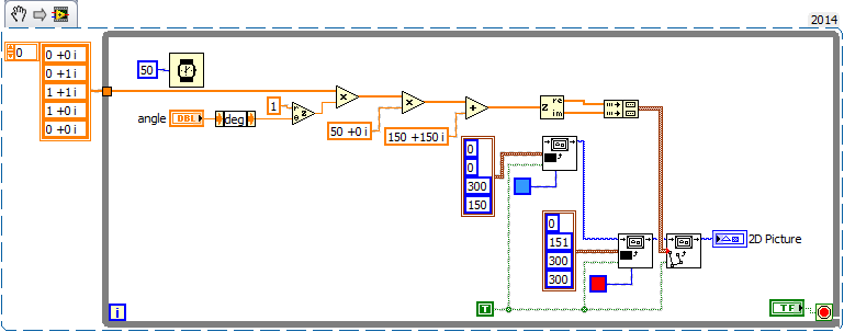

Hi kerim,
a small solution using some basic math (and complex numbers):
As I said before: calculate the coordinates of your "object" and draw it in a 2D picture indicator…

Hi Kerem,
you cannot rotate your image like that.
The point array is generated just for the DrawPoints function I used in my example!
But there are several threads in the forum that discuss how to rotate image data. Do a little search…
