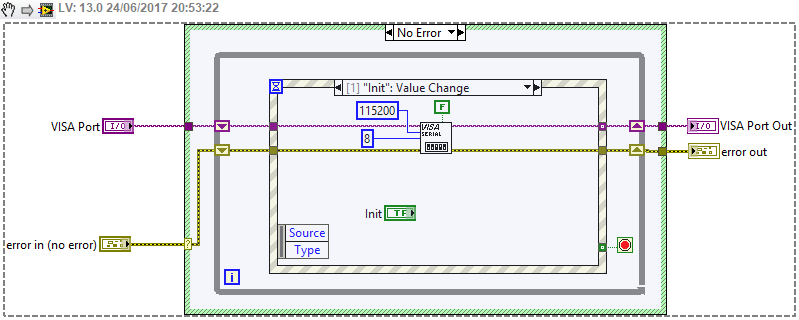

I'm uploading a VI I wrote that might work for you - it creates a connection using the VISA Serial nodes included with NI-VISA (but it won't tell you if you haven't installed that - so check!) and should have appropriate parameters for your device.
I'm also posting a snippet below - this is because the Code Capture Tool allows me to backsave a snippet, and it's easier than actually backsaving the VI. I do this because I'm not sure if you have LabVIEW 2017 installed (and if not, you won't be able to open the attachment). You can drag and drop the snippet onto a block diagram.
The code is written with the idea of you being able to make it into a subVI quite easily - you'd need to remove the loop and event structure and perhaps use a case structure to check the inputs and then use the same code that is currently in the Value Change event to make the operation, if the "Send Button" was true - this could be connected in a calling VI using a loop or event structure.
p.s. You should set the value of VISA Port before you press run.

I have tried to drag and drop it onto a block diagram but it does not allow me to do that. would you be able to save it in a previous version? (I have labview 2013, therefore I am not able to open your attachment).

Did it give an error message or dialog? The snippet was saved for 2013 so that should work (even though the attachment won't). Apparently some browsers cause trouble, so if it isn't working for you try saving the image to your computer and dragging from explorer.
The attachment below should be 2013 compatible.

I have just slightly changed your script and now it works perfectly well!!
