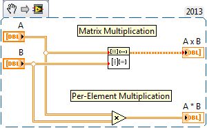

Using the regular Multiply function should give you the per-element multiplication. Please view this KB for an example on matrix multiplication: http://digital.ni.com/public.nsf/allkb/862567530005F09C862566F400818DC0
A snippet of the file is attached below:

This does not work however if the input is a matrix (RealMatrix.ctl). In that case, the multiplication is not elementwise but performs matrix multiplication instead. So far, using a formula is the only workaround I figured out. Any ideas?
(9,592 Views)
You can convert the matrix to a 2D array before the multiplication. this is just a very cheap typedef change and is done in place.
(9,571 Views)
Thanks. Yes, in fact, converting the matrix to a 2D array and then using the multiplication is almost twice as fast as multiplying matrices using formulas.
