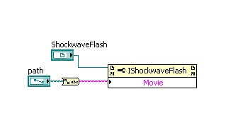

Using the method in your linked document, I came up with the following program:
 Try running this and let us know what happens.  The problem could potentially be with your flash file as well.  Post it if you want me to test it.

Thanks for your answer.
Thats exactly what I did.
Try with others ".swf" but only recognizes the ones made in AS2.
Here  are my files.
