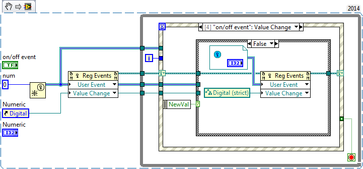

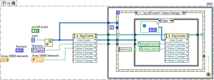

Maybe this example not very simple.
You can register event with empty constants. In this case event never become.

1)I have frame only in one frame (on/off).
If you will check in all events you will check many cases.
2) If you generate big data (array 10000 points), this memory frame will allocated and deallocated.
And your variant generate unnecessary events.
This simpler but not always better.
For controls on FP much better use enable/disable property
