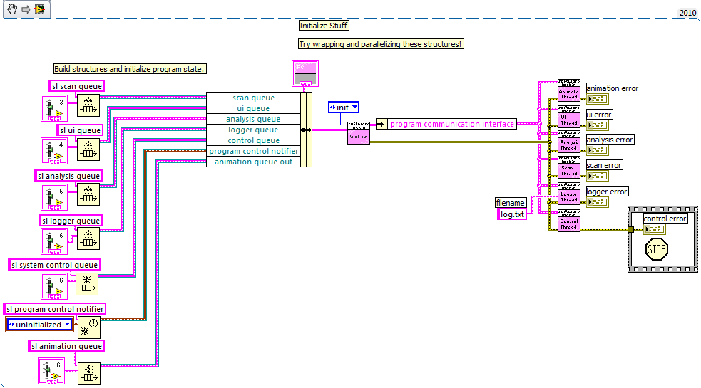

So I use queue to pass data between processes in my vi. There are lots of queues and lots of processes. Each queue has a typedef'd cluster as it's little queue payload. The overall topology of the vi is this:

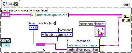

Deep inside one of the vi's on the right something like this is called:
When I run this, the enqueue gives me an error 1. Now, it didn't always give me an error 1. It used to work. However, as I've built up this vi, I've seen this problem often that I get error 1 when I enqueue to these queues. Sometimes I just run the vi a few times, or open and close stuff or save stuff and the error goes away (magically ~,~). My guess is it has to do with the fact that I change the type definition at some point and this change isn't digested too well by Labview. Does anyone else have this issue and is there any cure? Could it be something else I'm overlooking?

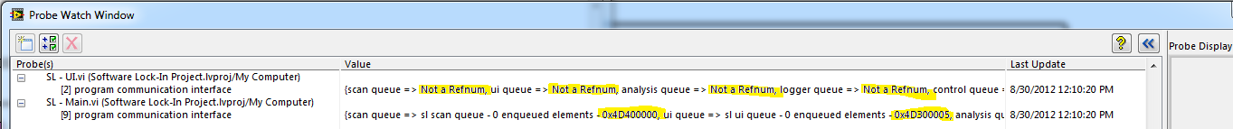

I guess I forgot to mention that (and I guess it IS more relevant): The cluster of queues I have is valid up until I pass it down into subvis.
So yeah, it has to do with the queue boggling up somewhere. I don't understand why. To give more context the cluster of queues is a typedef also containing the queue elements that are generated off of typedefs.
At [9] below is right before I pass the cluster to the subvis and [2] is inside a subvi, right after the input control.

Are you usnig the same code whatever you showed at the top? I see a stop function there what is that guy doing? I suspect that is closing evrything and you get invalid queue reference.
Message 9 of 18
(7,270 Views)
I agree that it shouldn't be there.  But I don't see that causing the problem (unless it's due to the memory leak we mentioned earlier).  The STOP is basically the same as hitting the Abort Execution button.  Not a nice way to end your application.  The VI should be able to end on its own.
