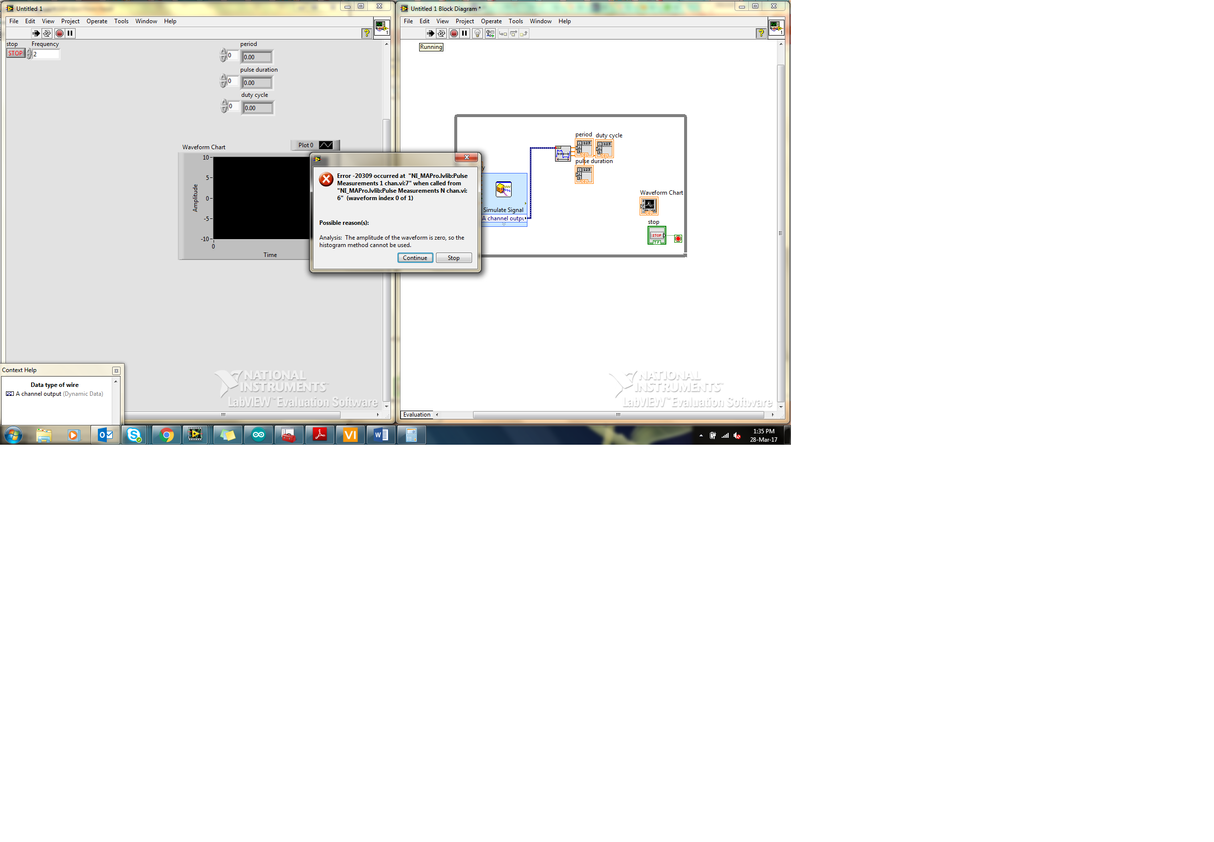

I received this kind of error :Error -20309 occurred at Amplitude and Level Measurements->practice.vi
 (waveform index 0 of 1). Possible reason(s): Analysis:  The amplitude of the waveform is zero, so the histogram method cannot be used.
I'm connecting the amplitude and level measurements to  a waveform chart. and i received this kind of error. Please help to solve this kind of problem.

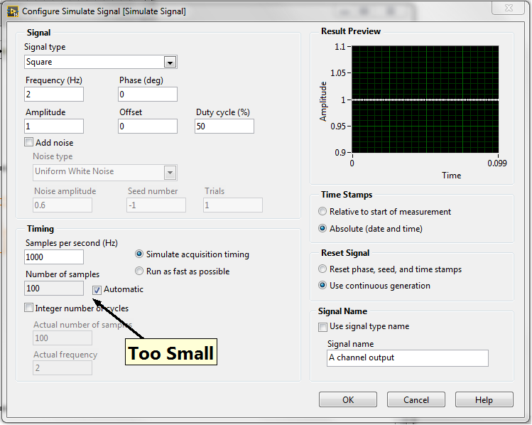

A full period of a 2 Hz signal is 500 msec. In the "Configure Simulate Signal", you specified 100 samples at 1000 samples per second. That's only 100 msec of data. There is not enough data to analyze the waveform.
As a minimum set (Num Samples) / (Samples per sec) to be greater that 500 milliseconds
