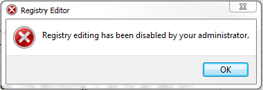

You may have found the hidden problem that has plagued ActiveX Excel automation for years.
But my company locks down Windows with security policies that forbids editing the registry so I will never know for sure...
=== Engineer Ambiguously ===
Message 11 of 14
(1,019 Views)
That security wall policy blocked me yesterday as well.
So I tested the solution on an development system successfully (where I have an admin account for such purpose) with just exporting the faulty entry into this system (error) and deleting it afterwars (no error).
Luckily our Company IT helped me out on this one and deleted the entry for me.
Works like a charm an I am still joyful crying for finding this needle in the hay.
