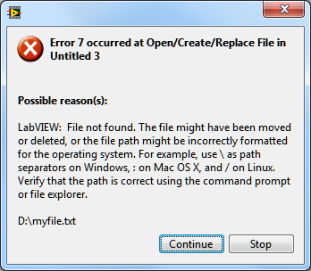

I believe this was deprecated in a newer version of LabVIEW (not sure which version). In LV2012 it's the "Open/Replace/Create" and it DOES give you the filename in the error dialog (near the bottom).
(3,259 Views)
