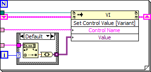

Here are some ideas, though, I'll suggest once again to translate the array of strings into one or more "objects" represented by clusters.  I usually create a VI just for reading/translating the parameters file, then pass a nice cluster-object around. Smiley Happy
But to address your question...
You could convert the string to a unique-type on every iteration (see pic.)
... or, instead of using the loop-index to select the type-case, you could pass in a type-selector the same way you're passing-in parameter-name and value.
