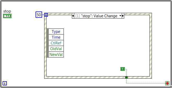

I did exactly that before I posed my question. It worked exactly as you discribed it. The problem is when I I add the motion back in it seems to inhibit the events. I had the Stop in the event structure, however it didn't work with the motionin the events.
I actually just created this event structure with only one event
The stop button will not stop the loop. The event structure stays in the timeout state.
