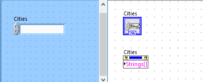

based on what you said and little search I tried to import an excel file with a report generation toolkit and get value by "Excel get data" block. I'm using Ring control as the Drop-Down menu but it needs to insert city name(according to my excel file arrangement) one by one and due to the big number of cities its time consuming, is there a shortcut to do it quickly?
(3,256 Views)
based on what you said and little search I try the report generation toolkit and "Excel get data" block. for the drop-down menu, I try Ring control and feed output value to my excel block to get data. but due to a large number of cities in my database, it's really hard to insert them one by one, is there a shortcut for that?
I'm using Labview 2020 version.
(3,287 Views)
Can you post your code? It would probably be best to use Save for Previous and save the file at least two versions back as many on this forum have not upgraded to the latest versions.
I don't understand what you mean by "insert them one by one." You should read your data in as an array of strings and use that array to populate your ring control. In any event if you have something that you are doing repeatedly for a set number of times you should use a FOR loop.
(3,269 Views)
Accepted by topic author Salivan
The RGT returns the data as an array of a specified format.  I suggest that you read the Cities Column as a 2D array of string, and then read the other two columns as a 2D array of DBL.  Then index the Cities to write the 1D array to the Ring Control using the Property Node Strings[].  When the ring value is changed, return the ring value as an integer and index the second array to return the positions.  I usually insert the word "Select" as the first element of the ring and offset the index by one before looking up the position.
