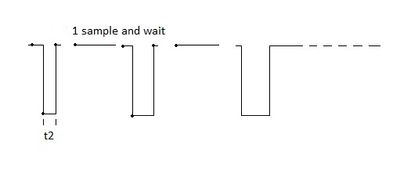

I'm working on a signal generation, it looks like that
because of the short times, making the whole signal as a wfm is not a good idea, so I want to make it like that,
so it turns out it will write twice each cycle of the loop, but there are some error(error code -200288) , I really can't fix out.
