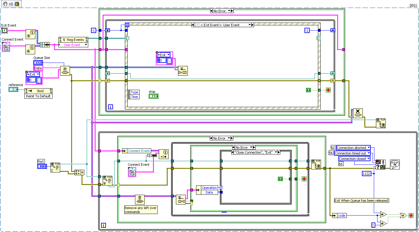

Use a second parllel loop that would monitor a stop button or some othe rmechanism to initiate a stop. The Create Listener would be outside both loops and the reference returned would be passed to both loops.
Here was an example server I posted a while back. Notice the Create Listener on the left outside of both loops. When the event structure detects the Stop button being depressed it exist the top loop. The Close Connection for the listener is on the right and because of data flow will run after the first loops terminates. That will result in an error for the Wait on Listener if it is waiting for a connection.

What if the "Wait On Listener" never gets a connection?  The vi will just sit there waiting.
Message 17 of 18
(1,453 Views)
If you close the listener reference the Wait On Listener will exit.
