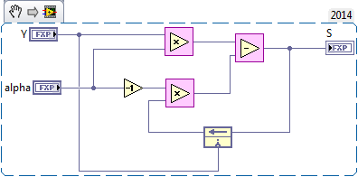

According to wikipedia:
https://en.wikipedia.org/wiki/Moving_average#Exponential_moving_average
You can calculate the exponential moving average as follows.
S[t] = a*Y[t] + (1-a)S[t-1]
This can be done with simple maths and a feedback node on an FPGA (I haven't bothered to sort out the FXP word lengths in the snippet below).

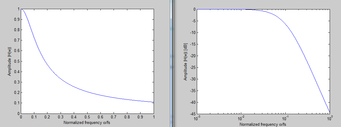

I just derived the frequency response of the EWMA:
|H(w)|= alpha / sqrt(1²-2*1*(1-alpha)*cos(w/fs)+(1-alpha)²)
I plotted it with MATLAB for alpha=0.5:
You can find my fix point version attached to this file. I have problems with the stability. The result sometimes jumps between two values...
Can someone find the mistake? I think it has something to do with the conversions...

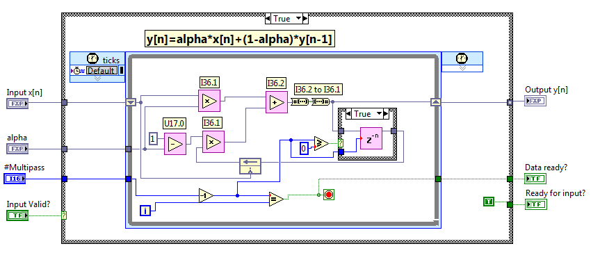

Hey Jim,
Q1 and Q2: I have this shift register, because later on I want to be able to multiple pass the input signal through the filter. That is how it will look like:
Therefor i want to scale the output to I36.1 again to have the same fxp type.
Q3: Ok i will change it the output of the subtraction to U25.1
Q4: You are right, I will try to make the code easier. I will built a testbench, were I fed the filter with a noisy DC signal.

So the actual error was beyond the filter at a bit shift...
I have now a working version, which can be implemented as a multipass as well. Can someone have a look at the pipeline logic?

Hi Slev1n,
Have you tested theses results against the original version? It looks like there may be some timing issues that would change the behavior. Here's a few suggestions:
  1. The Input Valid? signal goes through a feedback node and is offset by 1 cycle from the Input x[n] signal, so it would apply the next input sample, not the current one.
  2. Pipelining recursive paths is tricky, because the delays affect the transfer function. The problem is that you need a y[n-1] signal for the feedback path, but by the time the input propagates through the forward path delays, the best you can do is y[n-3]. There is a technique called lookahead pipelining that basically precomputes y[n-1] and y[n-2] to make this work. For your difference equation, you can compute y[n-1] directly (since you know the formula for y[n]):  y[n-1] = alpha * x[n-1] + (1-alpha)*y[n-2]. Repeating for y[n-2] and plugging all that into your original equation will give you the (somewhat more expensive) pipelined version of the original equation. A careful cycle-accurate testbench is essential for this sort of thing. I'm not sure what your "#multipass" input does, but that could complicate the situation further.
  3. Since your delays are known (other than the multipass thing), you might consider scheduling the handshaking yourself. In other words, leave the handshaking signals unwired and simply delay the Input Valid? the appropriate number of cycles to feed the Data ready? output. It looks like your diagram should always be able to accept new data, so you could just hardcode Ready for input? to return true.
Hope that helps,
