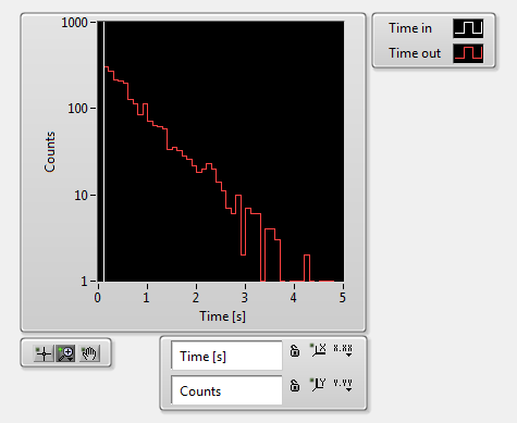

The attached XY Graph has two plots represented in semilog scale (linear X scale, logarithmic Y scale).
The two axes are set to not autoscale and I chose Y to start a 1. There are values of Y equal to zero in the plots.

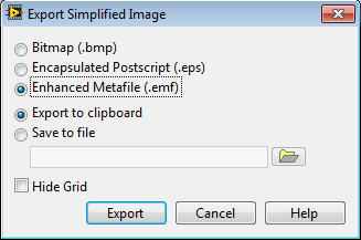

When right-clicking the graph and selecting Export>>Export Simplified Image... and then selecting the following options:

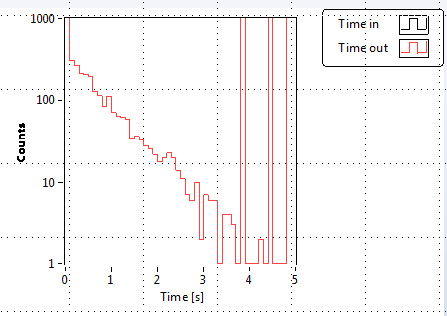

pasting the image into another software (e.g. Power Point) results in this:
Notice that the zero bins are now set to infinity...

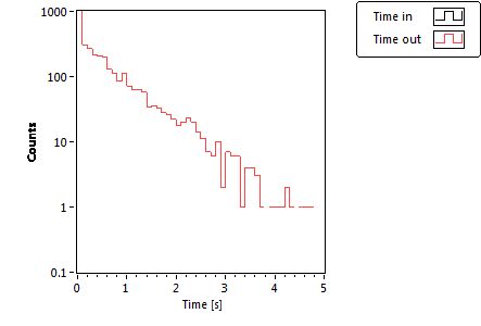

a work around:
replace 0 with NaN.
Then you get:
test.emf

We agree that NI does not do the right thing when generating the simplified image (they indeed apparently compute the log of the data again and rather than setting log(0) = NaN, they set it to +Inf).
Which suggest that if you have large data sets in a graph, the simplified image generation may take a while too (not checked).
