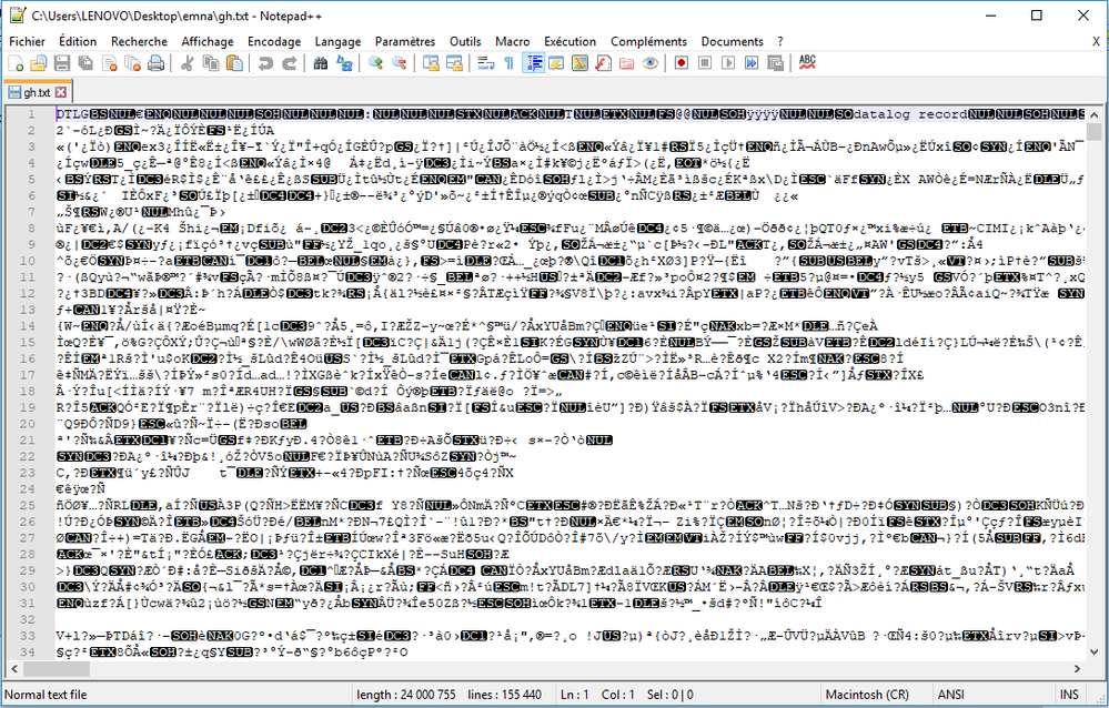

i obtain a text file see below .

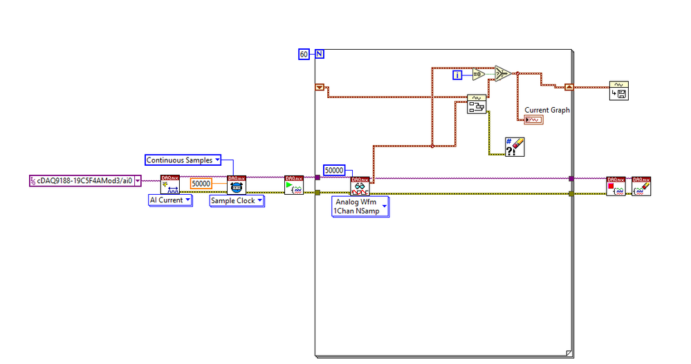

You might want to re-think what you are doing.  You have a loop that runs once a second for 60 seconds.  Each time through the loop, not only do you acquire 50,000 points of data, but you append them to an existing Waveform (which requires allocating 50k points each time through the loop until you have 3 million points(!), and also graphing all of them over and over again, which may take a little time.
Why not simply write the 50,000 points to the file, appending as you go?  No need to have all 3 mega-points in memory, simply dump them to disk.  Also, why are you plotting 50,000 points per second?  Why not decimate by 100 and plot 500 points a second in a Chart, which will scroll for you?  [You may need to see the entire record, so a Graph might be reasonable, but you certainly can't "look at" 3 million points ...].

Hi Emna,
No, you get a file with a filename using a suffix of "txt" - because you set that filename…

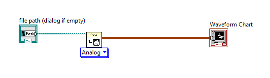

As can be seen in the screenshot you get a Datalog file, containing the waveform data!

i get the acquisition in 23/ 07 /2019 . when i read the Datalog file i found that the X axis is going from ( 1012982:56:58 ) to ( 1012982:57:58 ) . i want the X axis to be Always  from 0 Seconds to 60 seconds . How to do this ?
i want to know if its possible  able to extract the Data to Excel file ( csv or xlsx ).
( see below my  code for reading Datalog file ).

Interesting number that 1012982.  That is a number of hours.  Divide by 24 and you get 42207 days.  Divide by 365.25, you get about 115.5 years.  Interesting in that there are approximately 115.5 years between now July 23, 2019 and January 1, 1904, the epoch for LabVIEW time.  If you had the X axis formatted to absolute time, you'd see it has has the date and time the data was acquired.
If modify the waveform so that whatever t0 is now (some billions of seconds) to 0, that will give you a 0-60 second waveform.
