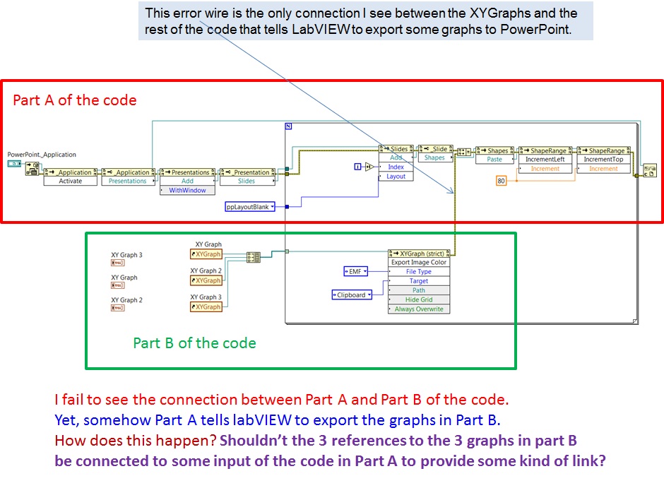

Darin, thanks for your replies. I must be running your patience.
I understand the reference to the graphs. I can right-click on XYGraph, XYGraph2, and XYGraph3 and create a reference for each one of them.
I also know that reference is simply a pointer that points to a particular object. So for example when XYGraph3 reference is connected to "XYGraph strict" method, the method performs an action on XYGraph3. I got that.
I aslo know what the for loop is doing.
HOWEVER, what I don't understand or see is the "Link" between the three graphs and the automation that tells LabVIEW to export those particular three graphs to PowerPoint.
See the attached picture and the questions I've written. Hopefully, this picture will illustrate what I am failing to see.
Message 12 of 31
(2,315 Views)
The connection is via the clipboard.  I call the method on a graph to place an EMF image onto the clipboard.  Notice the export target.  The error wire is for timing, I do not want the subsequent paste operation in PowerPoint to occur until after I put the proper image onto the clipboard.
This is automating the process you would go through.  Select Graph, copy, open PowerPoint, Create Slide, Paste Image, reposition.
Hopefully that makes sense.
Message 13 of 31
(2,312 Views)
It's starting to make sense. So which part of the code in Part A (see the diagram in my previous post) acts on the image on the clipboard. How does this part know that there is an image on the clipboard waiting to be exported.
Message 14 of 31
(2,305 Views)
The Paste method of the Shapes class does the dirty work.  It finds an image on the clipboard because you just put it there.  There is a tiny chance that some other program puts something else there in the blink of an eye between the copy and paste operation.  If you worried about that you would save the image of the graph to a file and then place the file into PPoint.  I prefer the in-memory process with the clipboard.
Message 15 of 31
(2,302 Views)
Thank you so much!! Great help!
Message 16 of 31
(2,302 Views)
