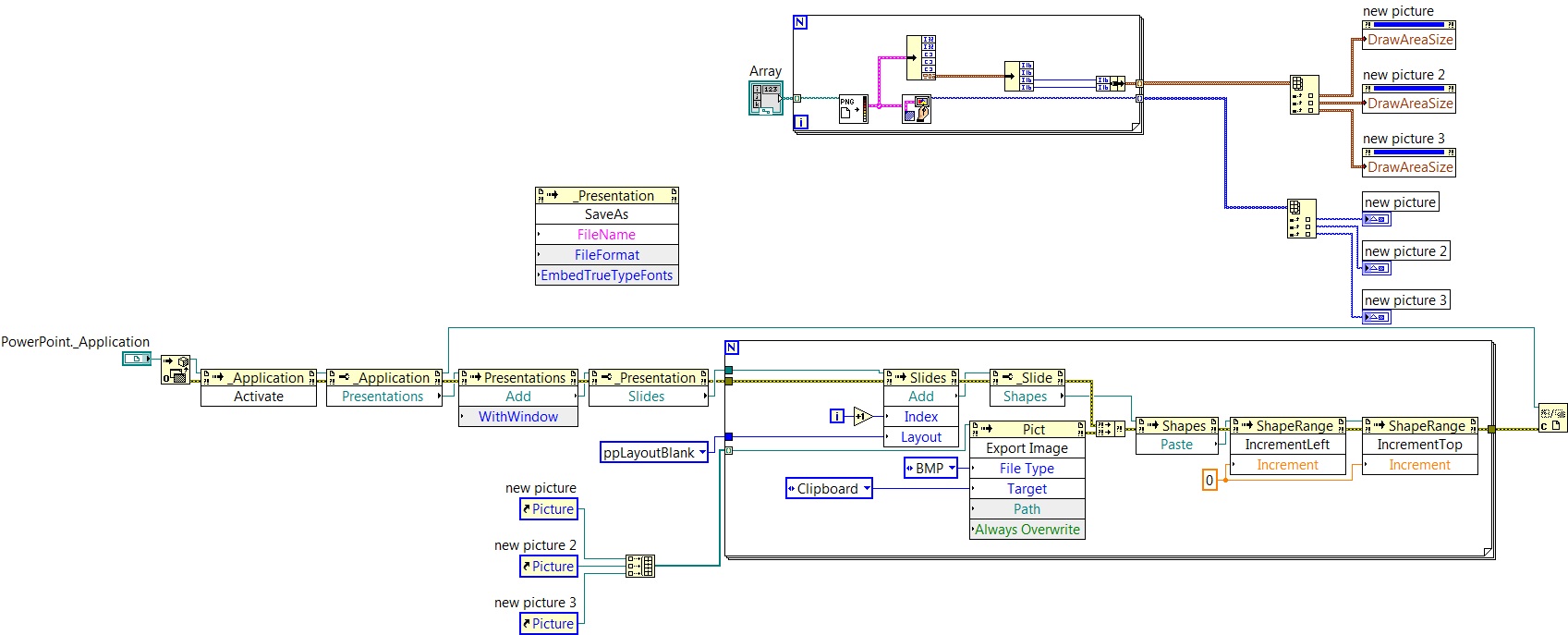

Two things you need:
1) You need to create a dataflow dependence between the loops you show.  Stub an error wire from the Draw Area Size Property Node or something like that which prevents the copy/paste for loop from running until after the pictures are created.
2) Insert the SaveAs method into the error wire which exits the copy/paste for loop and enters the Close function.  You can use the usual file path controls and functions to generate the path and then use path to string as input to the invoke node.

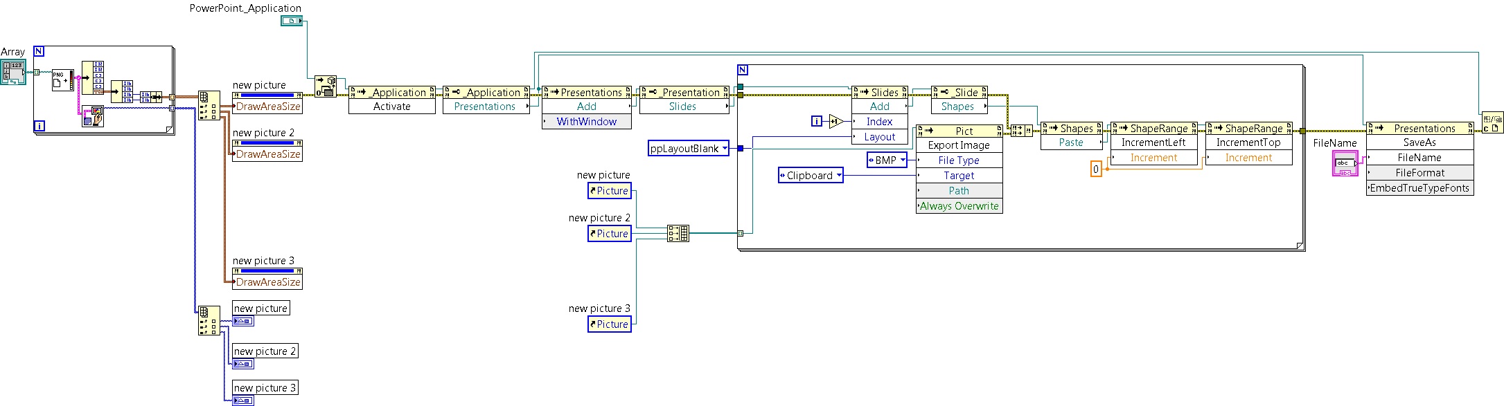

Thanks. I definitely lack theory knowlege and am reading up on it.
The dataflow part is easy and I took care of it, and also creating paths etc, easy.
I am trying to understand at what point the ppt. is created. Following the diagram, after the Application Invoke Method, right-clicking on it, I can go to Create Property, then I see Presentations.
So when I click on the Presentation and drop that Invoke Method, is that when a PowePoint document is created in the memory? I assume it must be created before the for loop starts,
because all I see in the for loops are actions that access the images and put them in different slides. So if I assume the for loop completes the ppt., then I inserted the SaveAs method
between the error wires of the for loop and close Ref. I get Invalid Method error.  Is is probaly because I am not wiring the correct Ref wire into the SaveAs method.
I tried different ones, didn't help.

You need to wire the Presentation reference, not Presentations

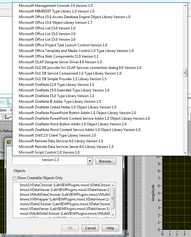

Thanks for your help. I suspect you are on to something. I have to admit that I don't have any experience with ActiveX, so I apologize for the completely novice questions. I just tried your suggestion and when I open the dialog to select the ActiveX Class, I'm not sure where to look to find the "PowerPoint._Application" class. I don't see anything under PowerPoint, Microsoft PowerPoint, etc. Can you give me more info on where I can find the correct class?
