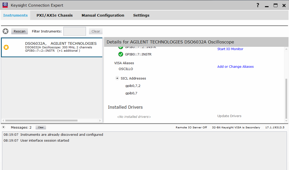

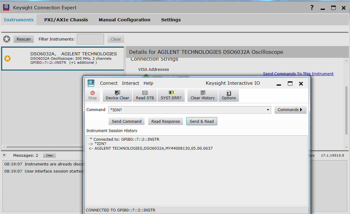

I can even see than my AGILENT is connected via the software i installed for the GPIB-USB :

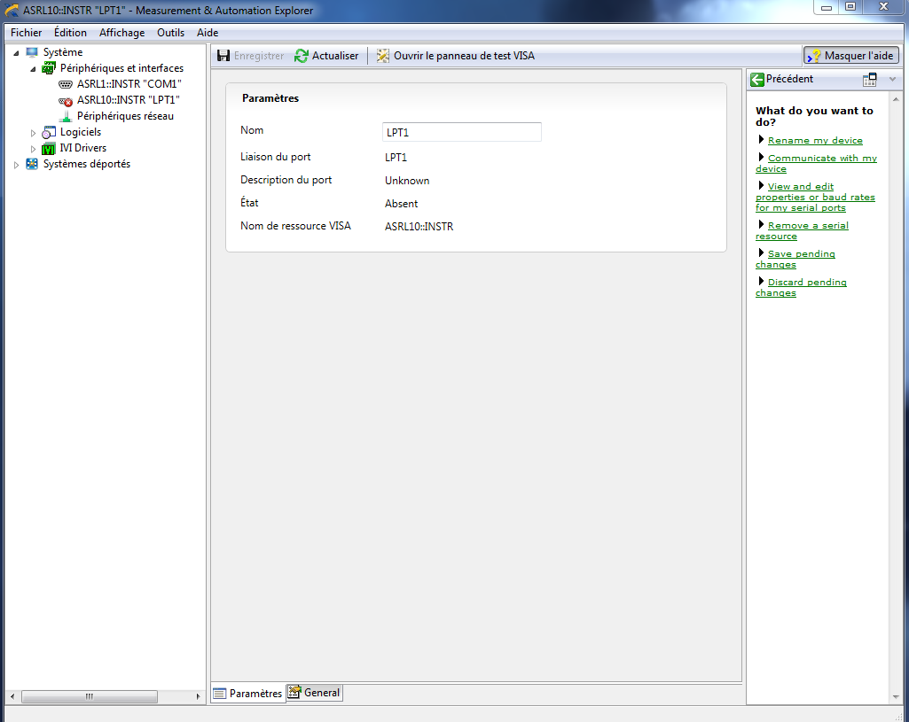

According to the instructions i found on ni website, i would then be able to find my AGILENT in NI MAX - Devices & interfaces (here "Périphériques et interfaces").
However, i can't find my GPIB interface. The only thing that appeared was the "LPT1" device, and when i try to open the VISA test control i get an error :
Error opening resource:
ASRL10::INSTR
VISA:  (Hex 0xBFFF0011) Les informations concernant la position sont insuffisantes ou bien soit le périphérique soit la ressource n'est pas présent dans le système.

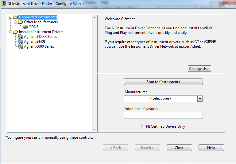

However, i already downloaded AGILENT 6000 Series driver on NI, which include the device i'm trying to use.
And it looks like the device isn't recognized by LabVIEW (cf Connected Instruments)
