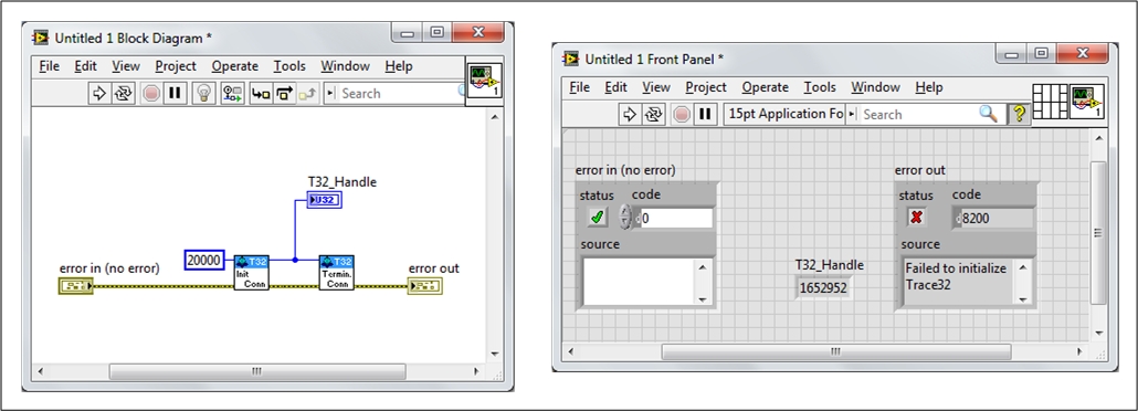

I've installed the VI according to the description and now I am trying to create my very first Lauterbach control program, which initialize the HW, produces a handle ID and then terminates the connection, according to the picture below. My issue is that I get the error "failed to initialize Trace32" in the error out box, which obviously is a clear indicator that my program fails to do what it is supposed to do. I tried to google this problem, but could not find a solution anywhere.

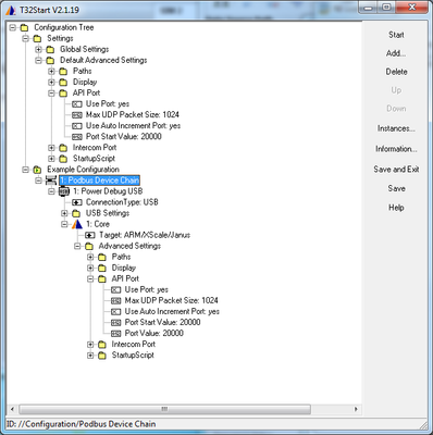

Also, what do you enter in the NODE & DEVICE fields of the Trace32_init.vi ?

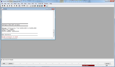

Yes, as a matter of fact I can perhaps help you. The whole point of the matter is not only to start the T32Start Window and enter the values from the pdf provided by Lauterbach. You really need to start the Debugger by pressing the start button in the frame to the right, that will enable a connection between the computer and the HW, which Labview can use.
Not enough (click start in the right frame):
This is what was required to be able to control the HW from Labview:
Not the best solution I've ever seen, but if this window is running in the background and I am able to control the HW from LV, then it is a small price to pay. 🙂

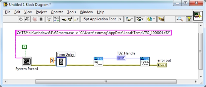

I've been able to write a small program which automatically opens the Trace-debugger and initializes the HW, so that the user doesn't have to go through the trouble of making sure a specific program is running on the computer. I would say that this code is what I was looking for when I posted my original question.
