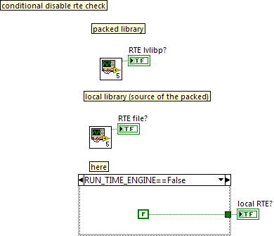

Screenshot of executable source:
First subvi is called from packed library, second - from original library, third case - diagram of the subVI locally.
(Name conflict (same subVI from packed library and locally) does not matter, in real life main code knows only packed library, not original one)
 Executable in the build.zip

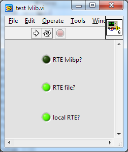

PS (edit): executable front panel (after run, all leds should be on, but lvlibp fails):

This is just a limitation on the PPL.  The Conditional Diagram Disable Structure works as a compile time decision.  And since PPLs can also be called by the development environment, the Runtime Engine conditional variable will still be false, with no way to have it recompile it as an exe build.
