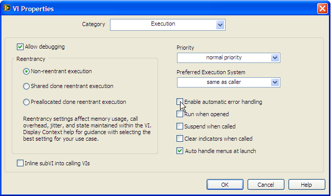

... and another thing!
Your VI isn't really "crashing", it's just stopping long enough to present the error message.  You can prevent this behavior if you disable automatic error handling in the VI's properties:
Jim
