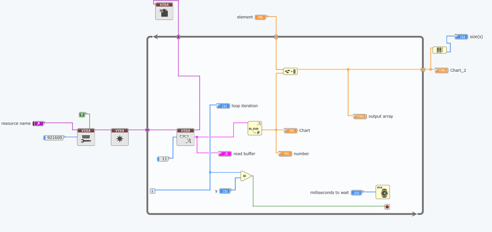

Hi there, I'am trying to store data from serial port into an array of dimension 1000, which I want to plot afterwords but doesn't seem to work. After getting 1000 elements from serial I only have two in my array. What I want to do is append every one of the 1000 values to the same array, but it doesn't seem to work. What am I doing wrong?Capture.PNG

I never used LabVIEWNXG before but I guess from your image you are building an array of 2 elements (displayed in "output array") in your loop. You create that array in each iteration and after the last iteration that 2-element array is output from the loop.
Does NXG support shift registers? Why don't you use them?
(2,806 Views)
Or have the output tunnel be autoindexing.  Also, your loop should be a FOR loop since you know beforehand how many times it should iterate.
Your use of "dimension" is completely wrong.  You are trying to create a 2 dimensional (2D) array with 1000 rows.

Thanks for info, but can you be a little bit more specific?
I' am  relative new to LabVIEW especially NXG.
