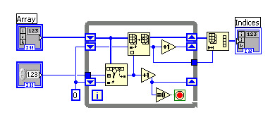

If I understand you correctly you would like to get the indexs of all the 1's (true) from the original array into a new array?  If so you can try out the below example (LabVIEW 7.1) or see the picture attached.  If not please clarify what you are wanting as an output...

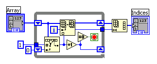

Here is a simple example (LabVIEW 7.0).

Additional comment:
If you are dealing with huge arrays, the "built array" node will slow you down due to memory re-allocation issues. For a much more efficient version, you can re-use the input array for the indices, then truncate it at the end using "reshape array".
Attached is a simple example, LabVIEW 7.0.

And here's another one..

Becktho, you're building an array with unknown final size which causes possible performance issues due to memory allocations IF the arrays are big.
True, I don't need the second shift register and can use the iteration terminal directly instead. (Also note that "reshape array" is a better and more efficient method to truncate an array instead of using "delete from array").

Hi Christian
The aim of my post was not to start the challenge who may code it better in terms of memory usage, execution time and speed, etc. I just simply wanted to show another way.
I'm aware of the fact of memory allocation and there are different ways to handle that. By the way - I think it is not the best way to replace the elements of the original array (although I can follow your code and although it is still possible to get the original values).
I think we should encourage others to think about different solutions - and not just this unique solution where memory usage is at 0.1%, processor load at 100% (we don't want to waste processor capacity)... I think you know what I mean. Often a more logically built vi is better for newbies than an extremly efficient one. I also think that you agree with me, if I say that there is not a best solution.
By the way - if you say that "reshape array" is better than "delete from array" - could you give numbers? Ok let's forget about the generation of the last element's index I've done in my vi - just the functions itself. For sure I'm not the ultimate programmer and there are lots of guys that are more experienced than me - but just saying "this function X is better than this function Y" without numbers or something similar - wow - that's quiet brave.
Don't think I can not be criticised and I don't want to criticise you. I've learned a lot from your posts (and I'm still learning), but I think the forums should not become the place to find out who is the best programmer (what sometimes seems to be the case). Don't link this to you - it's just something I sometimes feel when I have a look at a post.
Thomas
