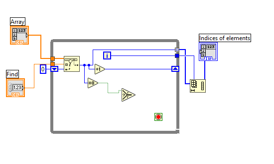

I guess you found my old code. (please have some respect and don't chop it up like that :o. You also need to stop the loop if the search returns <0. If it returns =0, you have a valid match)
"-1" is needed if you search for one and it is not found. Here you search for all instances, so if none are found, you'll end up with an empty array, which seems to be a clear result.
The output is now an array, not a scalar. If you want an array with a single -1 element, just detect if the result is empty and switch the output after the while loop before the indicator.

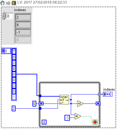

You are almost done. You are wrong with the value of zero. The function gives you value "-1" if the value is not found.
So you will get a single element array with value -1 if no match. If there are matches, you get their indexes, and a closing "-1" indicating there are no more matches:

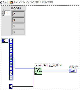

Or you can just use the OpenG Array addon function. Using this function, you only get the indexes of the found elements. If the search results in zero match, you get an empty array simply:

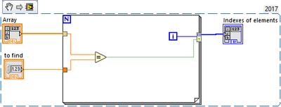

Here an other solution, you can add an incrementation for the indexes if necessary:
Best regards
Message 6 of 12
(6,255 Views)
Accepted by topic author Alyssa001
Best regards
Either using the Search function, or the above equal? function, never forget that it is tricky to compare floating point numbers. You might think 2 = 2, but in reality they are not exactly 2. You can switch to integers instead, or using some trick like machine sigma comparison.

My code from 2005 is from way before conditional tunnels were available. Yes, conditional tunnels provide now another solution.
(And yes, I agree that both search array and equal/not equal comparisons on DBLs can be problematic, so be aware of that)
