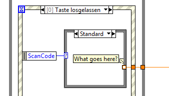

finish prompt user vi with "OK" via enter key press
I tried to use the ValueChange and also came to the conclusion that it is not what I want.
I wasn't aware of the issues you mentioned. I stumbled upon an even simpler one: one cannot accept the default value, because doing that does not cause the value to change.
I am not sure how I can filter out the Enter key properly.
I think the scan code is 43.
So I create a case that checks for 43 and does the regular things (passing the user input to the sub vi output). But it is a case structure which means I have to set up a stanmdard case.
I don't know what to put in the standard case. There is nothing to put in the standard case. I want to "do nothing", but data flow does not allow it. I have to pass some value.
When I put a constant value there, the window closes immediately. Every key triggers the event but I only want it to trigger when the enter key is pressed, that means checking what key is press
Please explain to me how I forward the enter keypress.

Keep you value in a shift register.  When some other key is pressed, you just pass the value that is in the shift register straight through.  In the case of the enter key, you pass out your new value.

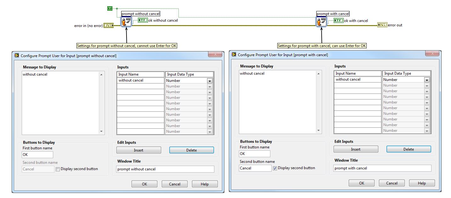

Interesting fact... if the second button is displayed you can use Enter for OK. See attached VI.
LV2013
Message 17 of 21
(2,095 Views)
Ran into this problem whilst writing a quick VI today and also noticed that "Return" was bound to Focus and Toggle on "OK 2" - removing this binding and rebinding the same settings to "OK 1" allows using the Enter/Return key in the way desired.

This example project should show the behaviour. I added comments to the subVI diagram to describe the process I used.
The project was created in LV2017 32-bit, and the zip includes a folder backsaved to 2014. I haven't tested the backsaved version.
The calling VI just displays the values in indicators to demonstrate they are set appropriately.
