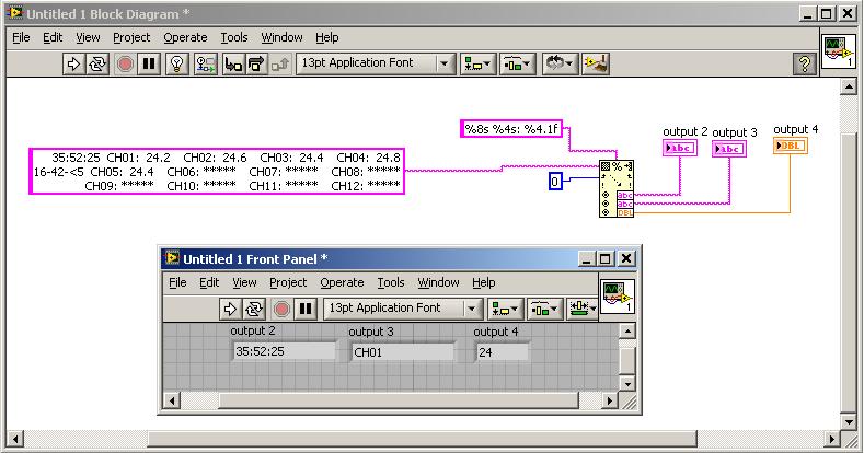

I am converting a string to several values, strings and numbers but when I want to convert a part of the string into a float, it seems that only the integer part is converting.
Can you figure out what am I doing wrong? I am using LV 8.6.1.
Attached is a pic and the vi.

Your attached VI seems to work properly in LabVIEW 2012.
You can also define your format string as %8s %4s: %f
leaving out the "4.1".
Sorry, I don't have 8.6.1 installed to test it in that environment.

I solved it. It seems to be a localiazion parameter, I am located in Greece, where the comma is the decimal separator.
So, instead of putting "%4.1f", I put "%.;%4.1f" and it worked.
