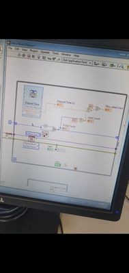

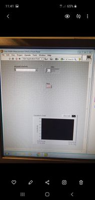

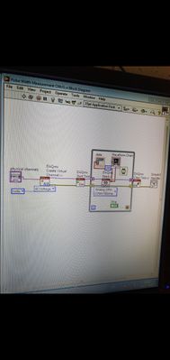

Hi all,
This is my program I have managed so far,  My attempt at measuring the flow and conversion from the pulses to litres hasn't been a success. My sensor is a Sea Water Flow Sensor, Model: YF-S201, it counts pulses of 450 pulses per 1 litre but I have been unable to achieve this conversation as it will need to display in litres on my graph.
Any help is greatly appreciated
(4,111 Views)
Why not attach the actual VIs?  I cannot read pictures of screens.
But since you are trying to count pulses, why not use a counter?  Then it is a simple division by 450 to get Liters.  What DAQ are you using?
