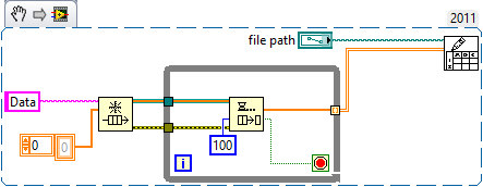

You can try this method to read all the data and write it to a file.

Here is one way to clean up your VI. Queue-2.2.vi
Often it makes more sense to write to file less frequently and to write larger chunks each time. I would probably simply keep track of the amount of data in the queue and then flush and write. when I reached the desired size. Or as BIll said, dequeue as the data arrives, accumulate in a shift register and write when appropriate.
I see you appeared to have a problem connecting the Flush Queue output to the Array to Spreadsheet String  function. This is because Flush Queue returns an array of clusters of array. Why does it do that? It cannot use a 2D array because arrays must be rectangular. The queue has no way to know in advance that all the arrays fed to Enqueue will have identical lengths. The cluster of array allows variable length arrays to be enqueued. This is described in the Detailed Help for the queue functions.
I have also included a somewhat simpler VI which does the same thing as your VI attempted to do. It uses no queue and no notifier. Queue-2.3.vi
