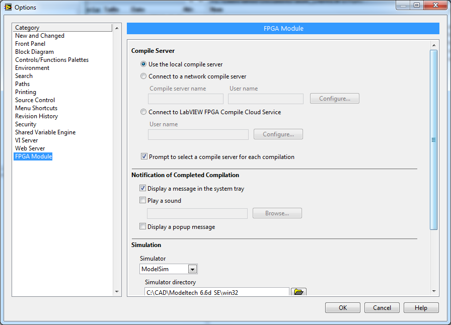

well i'm already made a local compilation, here's the proof :
I've tried to repair my installation, but nothing different after this operation
(3,350 Views)
