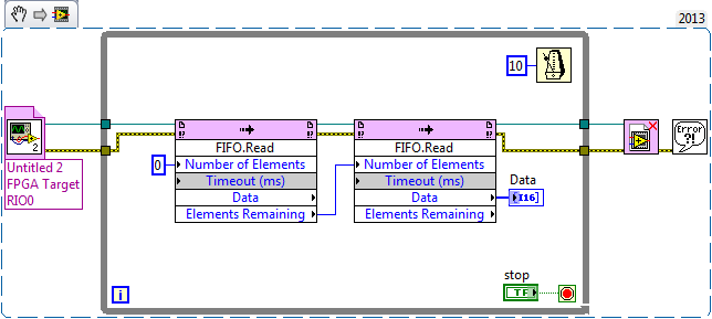

Are you reading multiple element at a time on the RT side, or are you trying to just read a single value? Since the FPGA is much faster, you'll need to pull multiple elements out of the FIFO at one time to be able to keep the FIFO from overflowing. One way to do this effectively is to use two FPGA Invoke Read Methods as shown below. The first node determines how many values are available to read and the second node then reads that many values.
I hope this helps.
Ryan

So, I did a test where I simply had 1 vi running with the Vi snippet you provided.   I ran into the same problem, where the LabVIEW code on the PC could not pull data out of the FIFO fast enough, so the code was unstable and the number of elements remaining slowly ramped upwards After a minute or two, the FIFO DMA buffer on the Host PC Filled up and then the FPGA threw a FIFO write overflow error.
So, the Labview code can almost pull data out of the FIFO fast enough, but it can't for this data rate, and I would suspect that if I added another 9234 card that this effect would compound itself and the FIFO would fill up even faster on the HOST PC, because the code can't empty the FIFO fast enough.
I'm guessing that you haven't tried to pull this data rate off of a NI-9148 yet.  I would Caveat this with I am using LV2011

Since the 9148 is an Ethernet chassis, do you have it connected directly to your PC or are you connecting to it across the network? Also, how many elements is your FIFO set up to hold? I'm sure you have tried this as well, but did you make sure to remove or reduce the 10ms Wait that I included in my code's loop?
I suspect the issue here is due to the Ethernet connection. Other cRIOs I have worked with have transferred at higher data rates than this without issue, so it should be possible.
