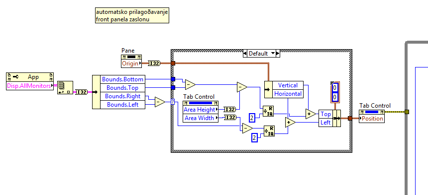

rt click on your tab control>>create>>property node>>pane dimension..

From your messages, I'll assume that you're not wanting to "resize" any controls, but just want to "reposition" the TAB control?  (If you do want to resize the controls as well, you'd have to take the attached vi and change vi properties as described in previous message to resize automatically according to screen resolution.
Attached vi has repositioning of Tab control to the center of screen if your resolution is 1600x900 or more. (Well, it's made to trigger with width resolution more than 1500, but I'm sure you'll get the idea on how it is doing things). In any smaller resolution it repositions Tab control to the vi origin (top-left corner of front panel).
