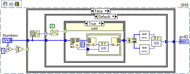

wiebe@CARYA wrote:
Or decimate the array in two arrays, and do the GCD of the pairs in parallel. Then recurse (yes!) over the results. Of course take case of arrays with odd numbers.
What would you do for an odd number?  I'm thinking that for a GCD function if you just repeated one of your elements to make it even again, the end result should still be the same.
Message 13 of 15
(1,099 Views)

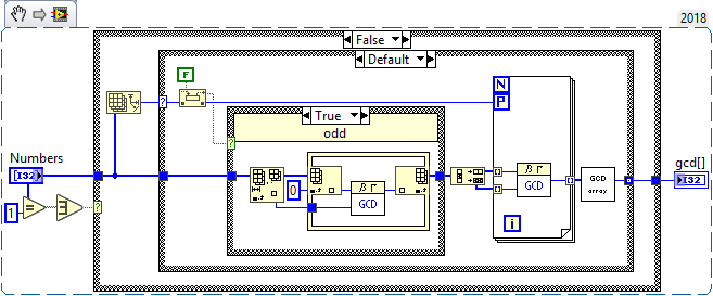

I was thinking in the lines of this:
Note that we can skip GCD-ing the rest, if any of the numbers is 1.
Also note the parallel for loop, that should benefit the speed.

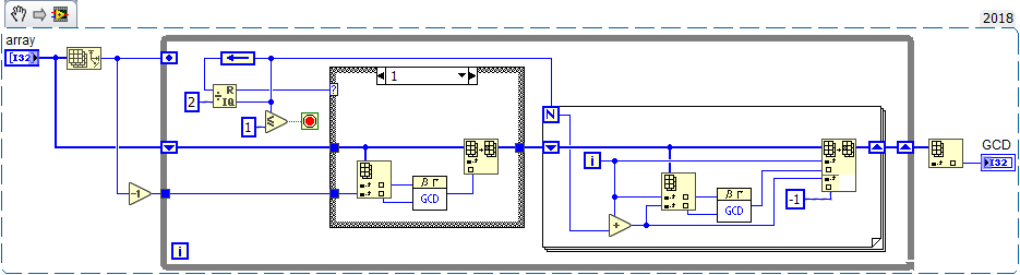

This would be an alternative, benefitting from 'normal' parallel execution:
I wander how these would perform in a bench test (but not so much to spend much time on it). It would depend highly on the data set anyway
95% untested, as usual...
