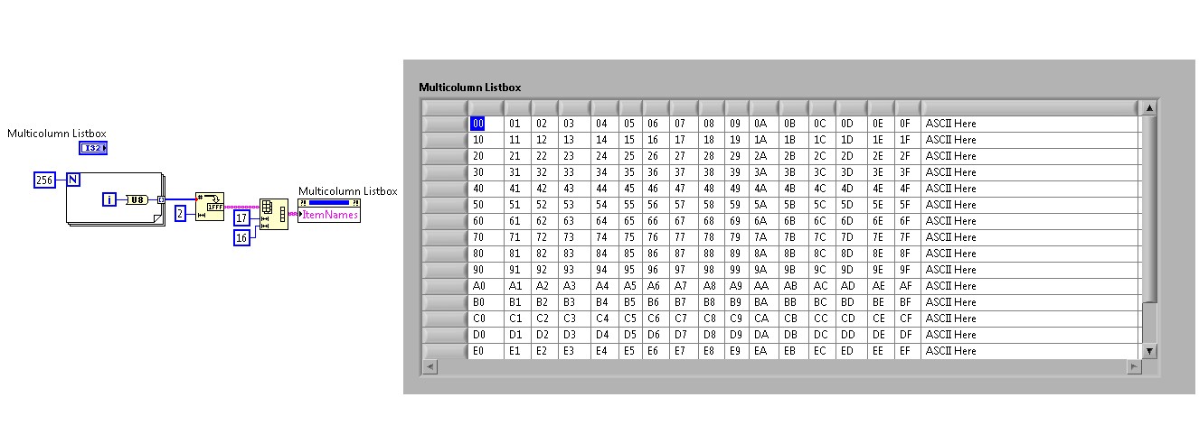

get all array elelments every 16 and put in single elemets and convert to ASCII
Hello everyone,
Please help me. i'm having hard time to do the attached image below can someone please see my code and , give me some advice.. I want to convert every 0-16 in ascii 17-32 etc and put ascii value right side of every 16 counts..thanks all.

Have a look at the Byte Array To String function. You can split up the byte array into 16 byte chunks, then call Byte Array To String on each chunk, then append that to each line of the table.

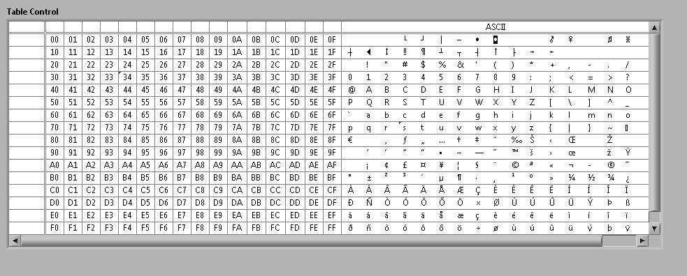

thanks Sir, I Just did..
but instead of using multicolumn listbox i used table..
