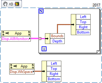

Application property node? Not VI?
Are you sure it is for front panel window size? Not for monitor? I don't understand this solution to be honest...

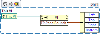

You had asked not to use the VI Properties, that is why I was referring you to the display properties.  Try

It works, thanks!
