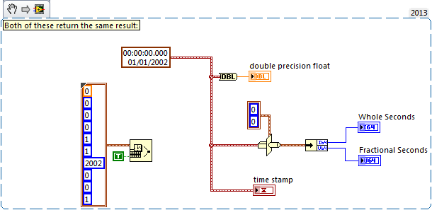

I think the documentation is wrong (shock horror!). Since you've piqued my interest, I thought I'd have a play...the best way to learn about something is to play with it!
No matter how I try to build the timestamp 01/01/2002 00:00:00.000 UTC, I always get 3092688000 for the number of seconds:
Anyway, the documentation states the I64 part is the number of seconds ignoring leap seconds. Where did you get your value of 365.2425 from? Looking online I found various values (e.g. 365.252222 was one which differs to what you have). I believe this is the source of your issue - the way LabVIEW converts a timestamp to the gregorian calendar is probably fairly sophisticated - taking into account leap days/seconds. If you divide the number by 86400 (seconds in a day), you get exactly 35795 days (exactly) which is correct.
Also note that using quotient and remainder with a floating point input can yield unexpected results (as per the note in documentation) - it is an integer operation.
Plugging the values (LabVIEW epoch and 2002) into an online calculator gives the value of 3,092,688,000 seconds which is what I get in LabVIEW (but differs from the documentation).
