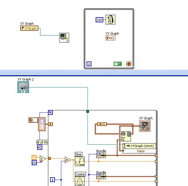

I have a subVI in a mainVI, among others. In my subVI I have a For Loop of 20 iterations and I acquire 2 signals at each iteration, which I plot in a XY plot.
What I want to achieve is to visualise the above two signals in the mainVI at each iteration of the subVI and not when the latter is finished. Is this feasible?

You can achieve this by using a reference of the graph from the main VI, pass it to the subVI vi and use a property node to update the graphs value.
I have attached an edit of your code to show this, labVIEW 8.6.

I am fine, thank you for asking. I hope you are also well today.  Thank you a lot for the solution, it really worked. However I would also like to learn more about LV, so I have some questions for the VI's you attached.
1) What is the essence of "include data type" in the Refnum control?
2)In the main vi you use a delay, is there a reason to do that? I don't judge your code but i see it as an opportunity to learn new techniques.
Also, what I want to do is to have the subVI in a for loop. In our simple case, to repeat the sine function for N times.  So, I would like to ask if it is possible to graph in the same XY graph, of the main VI,the values of all the N iterations but not one over the other but with progress in time.
Additionally, is it feasible to add in the same XY graph, of the main VI,multiple plots? For instance, instead of the sine function in the subVI, I have a signal and in a next VI i calculate it's linear fit. So, I wonder if it's possible to plot the actual signal and after that to add in the same plot it's linear fit.
