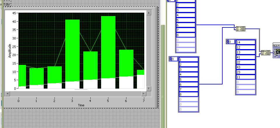

Is there a simple method to display data on bar graph where various Y-values for given X are staying like neighbors
but not like one Y above another Y (I've seen on http://forums.ni.com/ni/board/message?board.id=170&message.id=315293&query.id=2383347#M315293) ?
I made a lot of manipulation on set up on a legend (Common plots, etc) without success.
The only idea I have is to artificially offset X for all Y-values like this (X11,Y1), (X12, Y2) etc... and then plot it.
I'm sure there is a easier way to get my expectation.
I enclose a simple view how I want to get.

What you mean bar plot width or where to find it ?
I have LB 8.5.1, there is only Line Width for given plot and bar style ?
I can modyfie bars only in simple way as I showed below in the file, but this is not what i expect.

hi ckonio
  the particular bar command is a matlab command will be present in mathscript node..so please put a mathscript node and write the bar command ,adjjust the bar plot width and pass the two dimensional aray as input.
