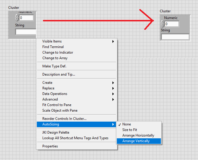

I'd suggest perhaps trying to change the Autosizing options on the cluster.
It sounds like either you have "None" or "Size to fit" selected.
If the contents are suitable, I'd recommend choosing one of the other options: "Arrange Horizontally" or my usual choice, "Arrange Vertically".
These will automatically arrange everything in a line and make the cluster small.
