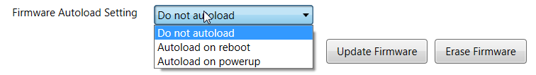

I don't know anything about the NI 802.11 application framework, but I do know that from NI MAX, you can download a bitfile directly to an (well..at least some of them like cRIOs) FPGA target.
When I select the FPGA target under 'devices and interfaces', I get the following options:
This allows me to load a bitfile to the FPGA target and specify whether or not to load it on start-up.
In LabVIEW and probably the C API, there options when deploying/running the bitfile to set it to load on power up etc.
