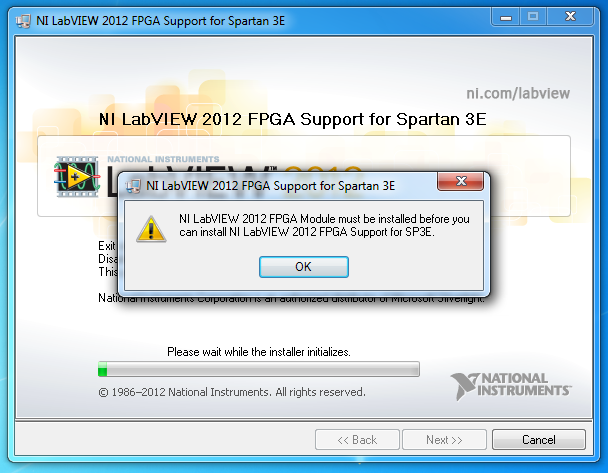

Hi
I have a project on Spartan 3e with Labview program but I can not install the driver cause of labview 2012 FPGA module

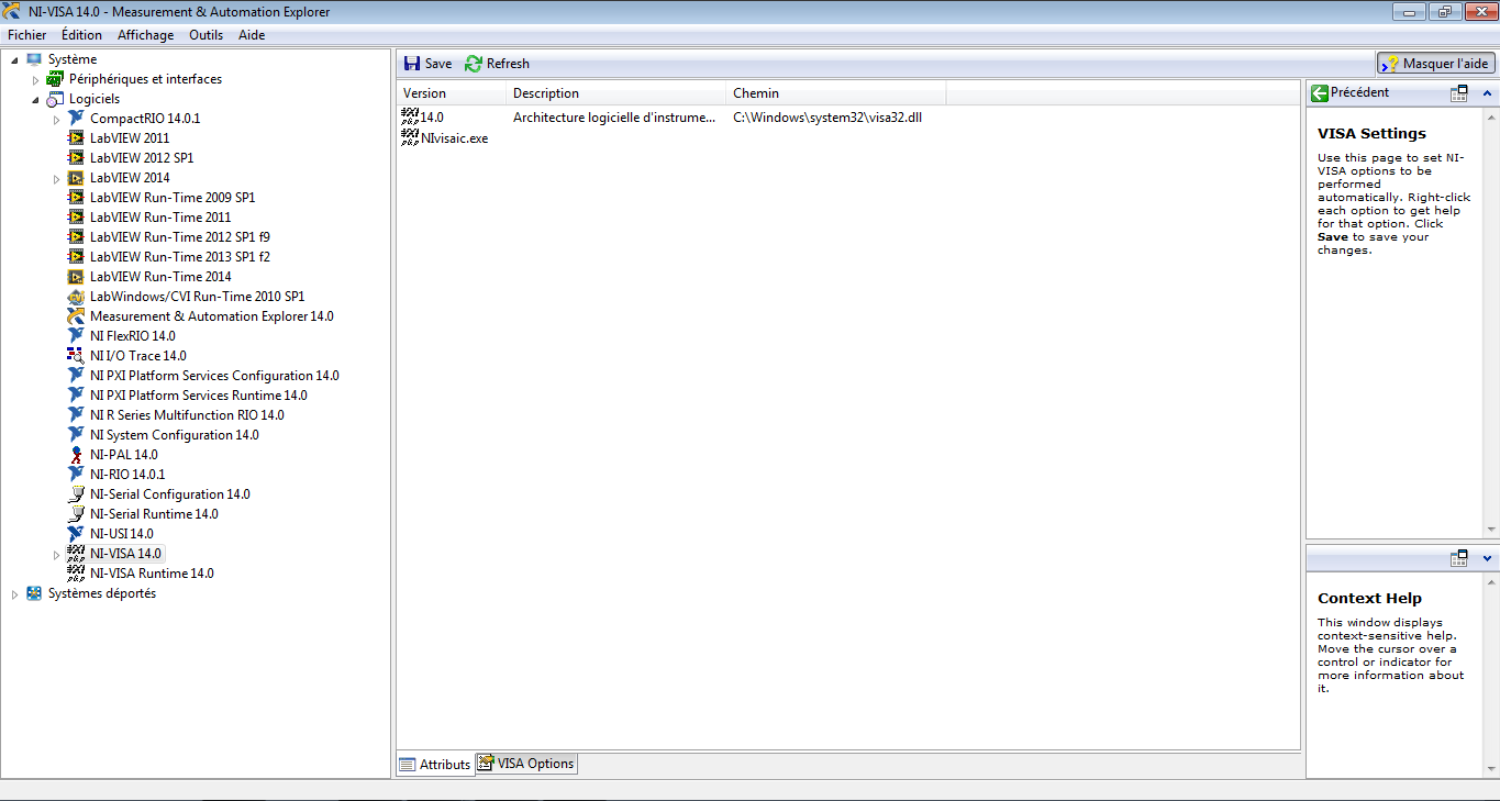

Hi raed58
- Can we check the FPGA Module version installed in your computer?  If you are not sure on were to look for this information, please follow the steps described in this link.
- Could you share a screenshot of the software installed in your computer under LV 2012 in NI MAX?

Hi raed,
there is just LV2012SP1 - no additional toolkits or modules.
Please install the LV2012 FPGA module before trying to install Spartan support!
Btw. there are some modules/toolkits installed for LV2014 as you can see by the triangle left of the LV2014 item…

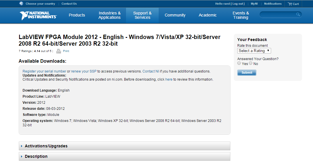

Hi again :manhappy:
Why i can't download the fpga module on this link : http://www.ni.com/download/labview-fpga-module-2012/3088/en/
can anyone send me a link to download the module?
Thanks Smiley Wink

You know, every question you've asked us so far has been answered by the dialogue presented to you.
Why couldn't you install the spartan tools?  You didn't have the 2012 FPGA module installed.
Why can't you install from that link?  You don't have SSP to download older software.
Do you have a license for the FPGA module to make it worthwhile for someone to upload the module for you?  If not, there isn't much value in that task.

Hi raed,
and please stop asking the very same question by PN when you already asked them here - and you already got an answer in the forum!
You just need to read the dialogue you have on your screen in front of you - like natasftw said!
As I already answered by PN: Call your local NI sales guy to discuss any license issues!
