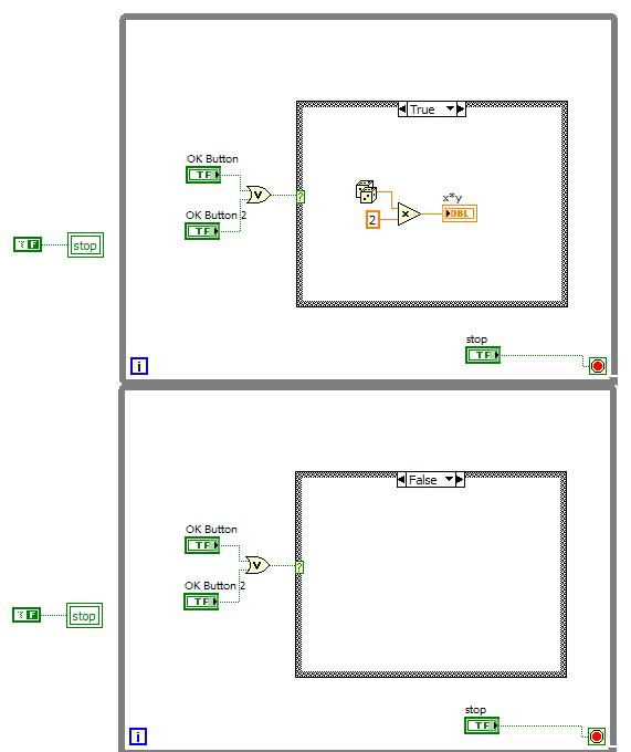

Well guys, I just want to make a simple thing here but I'm having problem here:
I have 2 booleans and if one of them is "1" my case structure should work until I click on stop.
But i'm clicking on the boolean the program run one time and after it it just stop.
Could you help me? I will attach an image:
How can I make the part inside case structure runs until I click on stop?
Thanks for the help guys!

Do you have the Mechanical Action of the OK buttons set to Latch?
If I have understood this correctly, the logic you want is Exclusive OR, not OR
James
Edit: You also have a race condition in your VI, Replace the Local with "Reinitialise to default" Invoke node and wire the error out on to the while loop to set Stop to false before you start running.

Probably latch is on. If you want to visualize it, run it with highlight execution on. That will give you a clear picture on what is happening.

u may delete the stop button then right click on the terminal (the square with red point) select create control.

The button is "switch until released" and I didn't understand the others comments.
I know I have a race condition but this is only an example... my major problem is to know why even with clicking in the button OK the program don't stay running x(
I tryed with latch but wont work, only if I clicked on it for ever....
Thanks but it wont work yet!

Does this VI help understand my comments?
Does this do what you wanted it to?
James
Edit: add pic
Message Edited by James W on 05-19-2010 01:41 PM
Edit 2: I got the Boolean VI control actions wrong - they are currently switch when released not until
Message Edited by James W on 05-19-2010 01:43 PM

I am not sure that I understand what you want the program to do.  Looking at it, it appears that the x*y indicator will get a new random number whenever one of the OK buttons is pressed (while it is still pressed - try holdin down the mouse key), and the program will terminate when the stop button is pressed.  Is this not what it is doing?  With an action of switch until released, you will only get a "1" from a boolean as long as you hold down the mouse button.  Try the "switch when pressed" action to have the code in the case continue to run after pressing and releasing.  Also it might work better with a small delay in the while loop.

James, Now I understood thanks 😉
lmtis, you are correct my friend! I did it and works very fine....Now I have to implement it to my program
thanks mate 😉

Ok thanks guys, I have fixed that!
I was invert something wrong... so my program was ending every time haha
thanks for the help!
